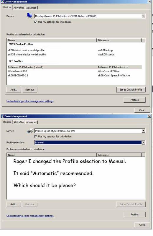

                      • #41
                        Re: Printing from Lightroom
                        It looks as though you are almost there Audrey, but you should confirm that your Spyder profile is being applied.
                        When you go to Colorcpl > Devices in the Device window at the top you should see 'Generic Non-Pnp Monitor' followed by your graphics card details, and in this window you should be able to scroll and see your printer profile if you have installed one.
                        The 'Use my settings for this device' should be selected.
                        In the main window below, under 'ICC Profiles' you should be seeing the Spyder profile. Click on this profile, and then click the 'Set as default profile' box.
                        The screen brightness is very probably the reason that your prints are darker than on screen. When you use the profiler is there an option to adjust the brightness?
                        Roger
                        • #42
                          • #43
                            See screen grab to see if they are OK please.
                            Roger
                            Yes, there is although Spyder recommend that it is left as it is for an LCD screen.
                            I did lower it, but the result on screen did not look good at all.
                            I am not sure whether it is too saturated or too dark.
                            Anyhow I have done a few prints and I keep altering the brightness.
                            Overall the colour is as near as I can get it I think, bearing in mind that I am using third party inks and paper.
                            I used 3 different types of paper including Epson Premium Glossy and I couldn't tell the difference between that and 7day shop Glossy 270 GSM paper.
                            I will use my best stuff for competitions.
