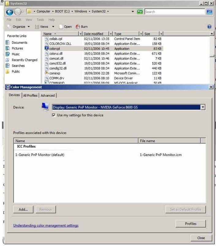

            And yet another screengrab of Colorcpl. I had noticed that this morning, but you called it Colcpl, so I didn't think it was the same thing.

              Hi Audrey,
              I realise that I am stepping into a minefield here because there are so many people with their own ideas about colour management and workflows,but we could make a definite first, and the most important, step by setting your monitor to use the Spyder profile.
              1. 'C' > Windows > System32 > colorcpl
              2. Click on 'Devices' and your 'Generic . . .' profile should be shown.
              3. Click on 'Use my settings for this device' - click the 'Add' button.
              4. The 'Associate Color Profile' window will open.
              5. Scroll down and click on the '1.0.5-1 Color Vision' profile and click OK.
              6. You will arrive back at the 'Devices' window, and the Spyder profile
              will be listed.
              7. Select it, click 'Add' and then click on 'Set as default profile'
              A pretty long procedure, but you should never need to do it again unless you change monitors. Spyder should automatically install any new profile you make as default.
              That's a start anyway,
              Roger

                Hi Roger
                I got so far but could not see '1.0.5-1 Color Vision' (only the Generic one, which when I chose the Profile Chooser [screengrab last night] and clicked "About", showed the Spyder logo.)
                See if you can see it in my screensgrabs attached.

                  Sorry Audrey but I think that I may have missed a step although there do seem to be some subtle differences between the screens we are seeing.
                  When you click on 'Devices' make sure that ' all monitor profiles ' is selected.
                  From the evidence of all your screen shots there is no printer profile on your machine. This is not surprising because Epson have not issued a Vista driver for the 1290 as far as I can find out. If I were you I would try a Windows 200 driver which is available from HERE It may work!
                  Roger
