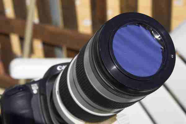

        you can easily make a cheap solar filter using 'baader solar film', or you can purchase specialist solar filters. the one i use on my scope is made from baader film.
        do not be tempted to use 2 polarised filters at 90 deg to each other as they will not remove the harmful ir and uv rays that genuine solar filters will. similarly, using a piece of welding glass 'works' but the optical quality is very poor. there's annecdotal evidence that floppy disk material can be used, as can stacking negatives. when it comes to the sun though, you only get the one chance to get it wrong and you don't even feel any pain while the retina gets burnt (there's no pain receptors on the retina).
        when it comes to the sun, i'm fastidious in how i go about imaging it.
        i'm not sure if you are on the path of totality, however if you are, then the filters can be removed during the totality phase. this will allow you to capture the corona and also the diamond ring (just as totality starts / ends) where the suns rays shine between the mountains on the moon.
        when i shot the annular eclipse in spain a few years ago, i made a fliter from film attached to a cokin filter holder -
        but also used 2 cameras, allowing me to do this.....

          i should add, that as long as you have a solar filter over the lens of the camera, looking through the viewfinder is absolutely fine. i do this with my scope with the magnification up at around 200x, but as the baader film has cut out 99.999% of the light, there is no problem.
          you should check the filter for defects first though. hold it up to the sun and if you can see any pinholes of light coming through, do NOT use it. if you really have no other option, tiny holes can be repaired with small pieces of pvc / tank tape placed over the hole, however the image will probably degrade a bit.
          don't forget to get yourself a pair of eclipse glasses. these are made from baader film, and will allow you to see the eclipse for yourself rather than on a camera screen / viewfinder.
          if you can't get a filter for the camera, an alternative is to project the image of the sun onto a white piece of card / paper and photograph that. there's enough stuff on the web describing how to do this.

                    If ND400 is a neutral density filter, then NO. It will most likely not filter out the uv and ir that really do need to be filtered out.
                    http://eclipse.gsfc.nasa.gov/SEgoogl...20Agoogle.html shows the exact ground track, and yes, Tokyo is bang on the central line.
                    As for lenses, I was lucky that a 28 was sufficient, but for the close up, use your longest lens. If you can use an extender on the 200 then do it. The sun is still quite small in a 200. You can check the size taken on the photo by shooting the moon at night. That is after all what you'll be shooting on the 21st
                    Plan the shots you want and the times between photos. I'd recommend photos every few seconds during the moon-fully-over-the-sun phase (termed 2nd & 3rd contact). If you do a wide angle shot and the sun creeps towards the edge, you can easily recompose and sort out the difference in post processing, but it's better to get it right to begin with.
                    You NEED to get proper solar filters though yoshi. Uv will seriously screw your eyes up.

                        it is worthwhile getting as close the the exact centre line as you can as you'll end up with a perfect doughnut image at the midpoint of the eclipse. moving away from the centreline will offset the inner ring accordingly.
                        I still do not fully understand what a sun filter is. Will look for it in Tokyo when I stop over there.
                        essentially, it blocks all but a tiny bit of the light from the sun, and, importantly, blocks the UV and IR
                        I also have in mind to use an old floppy disk sheet or DVD for compact cameras but not fully sure if it works properly.
                        not something i've tried so can't offer an informed opinion, however most stuff i read say this is a 'bad idea'.

                          Taking into the advices into consideration, I placed orders for a sun film sheet (B5 size=25x18cm) and a ND100000 filter at amazon and expect to receive them tommorow.
                          I'll cut the sheet so that it fits compact camera lens sizes and for 24mm lens. Instead of using two or a few ND400 filters in pairs, I finally chose to use a single ND100000 filter for an old 35-350mm zoom lens.
                          I thought first that I can use ND400 filters for other normal shot purposes but decided to concentrate on the eclipse shots.
                          The sun film sheet is not 100% effective against IR and the sun will be a bit redish.
                          About the exposure setting. When AE does not work properly then I have to use Manual Exposure. f1/8, 1/320 sec. to 1/640 sec, ISO 200 would be a benchmark? OF course, I will make a slight adjustment on the spot.
                          ND100000 reduces the sun light to 1/100000. No idea about the sun sheet.
