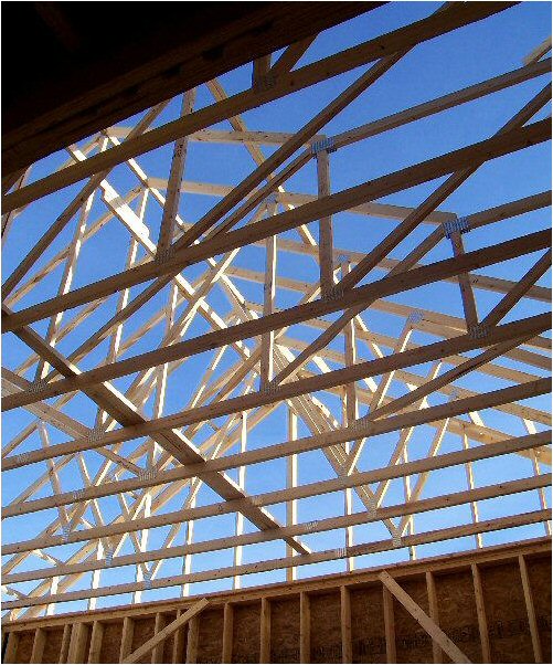

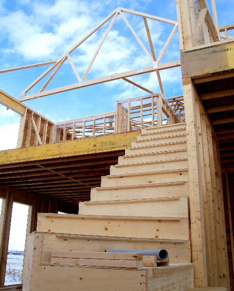

      These two photos aren't bad for lines at around 45 degrees, but when lines approach vertical or horizontal, they really become apparent, at lest on my computer.

        Re the jagged lines, yes they are very visible on my monitor.
