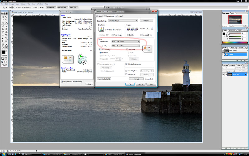

              Dear All,
              Thanks for all the help. sorted it. I can now print borderless from photoshop 7 (Yep still haven't splashed out for CSx) and lightroom.
              There was another setting which I have no idea why it is there bit you pick output size as well as paper size and I get borderless prints on all 4 corners.
              here is a picture. will post a my opinion of the 2880 when I get a few mins.
              Best regards
