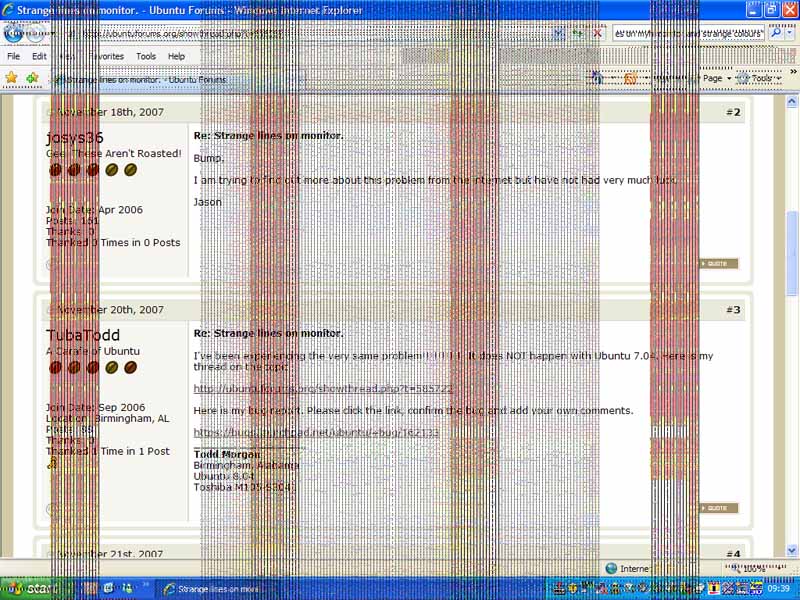

    I am attaching a screengrab. Can anyone confirm for me that it is the graphics card that is failing?
    It's very difficulty for me to see what I am writing.

      I think its fair to say the graphics card is b*****d.
      I'd just go to the nearest computer shop and get a new 128mb ATI Radion or equivalent card. I don't think the exact model is too critical. They have the same fitting and should be a simple plug and play installation. Though it may come with a driver disc
        Re: New Graphics Card Required
        looks like it. i'm surprised that you're limited to just the one card though. check ebuyer.com as they're usually pretty competitive on pricing.
        is the fan spinning on the graphics card?
        do you get the lines as soon as the pc is switched on or after it's warmed up a bit? if the latter, then something, probably the graphics card, is overheating.
              I thought you meant one card in my computer! I now think you mean that there may be a compatible one of a different make. The trouble is, I wouldn't know what that was.
              The screen goes criss-crossed as soon as the computer is switched on.
              I have now removed the Graphics Card and the fan will spin if I move it - it isn't stuck.

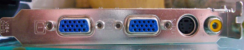

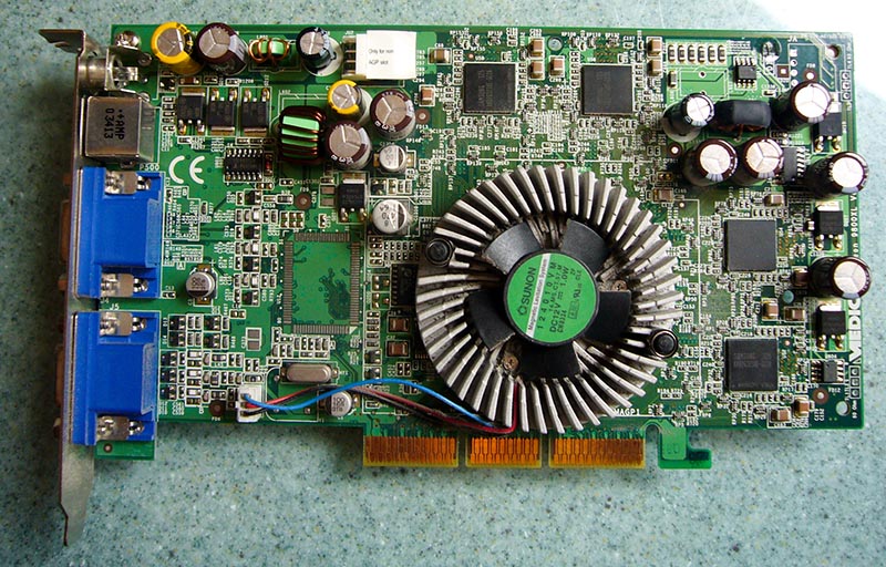

                I am attaching 3 photographs.
                I do not understand why I would want a splitter as this Graphics Card just plugged into the Red Slot on the picture and was fastened with the plastic clip and then had one screw to secure it.
                If anyone can throw any light on what alternative might fit, I should be grateful. Failing that I shall be hawking my dead Graphics Card around town in the morning.
