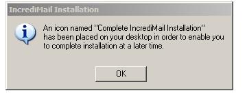

      When I boot up my computer, I also get the following messages:-
      When I click on the Icon to complete Incredimail Installation it says it is "Unable to download installation script and I am to try again later". I just keep going round in circles.

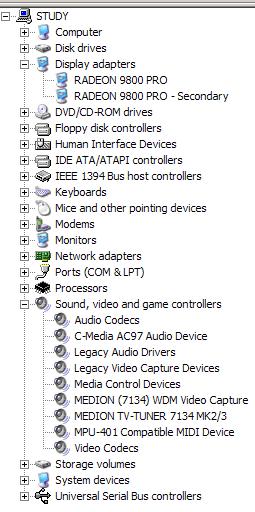

            Do you know to tell me what is your computer's configuration?
            For example what is your graphics card and what is your sound card?
            (For example you Graphics card might be a ATI or Nvidia and your sound card might be Soundblaster, or Realtek or Nvidia)
              Re: Volume Control missing from systray
              Is it on here George?
                Very Good Audrey! You are a smart woman
                Indeed your sound card uses Realtek AC97 drivers.
                Go to the following website and download the correspondent driver for your operating system (I guess windows XP).
                Run the setup file and follow the procedure to install the driver. It is easy.
                George
                    George
                    Thanks for your help George. Well that did work and the Volume Control returned to the systray. It vanished during yesterday, so I did a system restore and it came back again. I have just looked again and it's gone again! May be it will return when I reboot tomorrow.
                    I keep meaning to get out my software for the keyboard and mouse and see if that activates the keys again. If not I will just have to manage.
