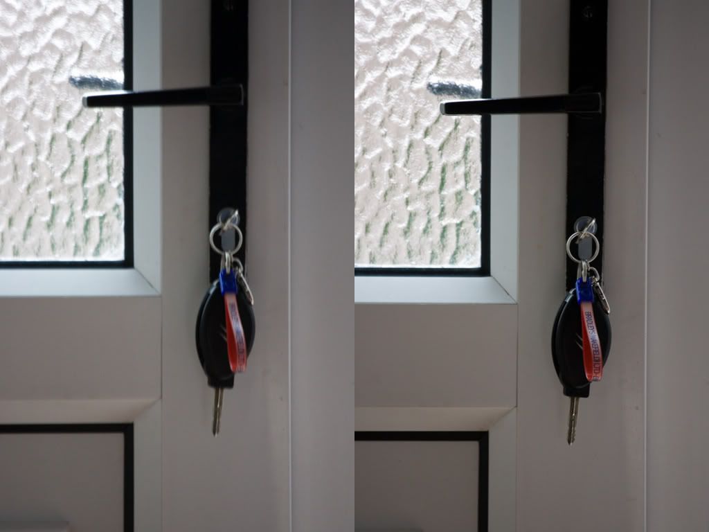

    I've just taken the first two photos with my new Canon 100-400 IS lens. I had put the Kenko UV filter on that came with the lens and thought things looked a bit soft through the viewfinder. So sat at my desk and focusing on the front door (why walk any distance eh ) I took a shot with the filter on. Took the filter off and did the same shot again. Both shots taken in Raw at ISO 800 which gave me 250th sec at f5.6 and with the IS switched on.
    As you can see the difference is marked. Needless to say I won't be using this UV filter again. Moral is buy a good quality filter. Putting a cheap filter infront of quality glass is a waste of time.

    That is quite revealing Stephen. As a matter of interest do you normally have a UV filter on you lenses and if so what make do you use. ? I normally have a UV filter on to protect the lens and use Hoya filters. By the way happy to see that your lens has arrived OK.

      Indeed it is revealing Dennis. At present I don't have any filters on my lenses, and it is essentially for this reason. All my lenses use a 77mm thread and to buy a quality filter of that size is rather pricey. Don't think because its Hoya you are OK either, because there are different qualities of Hoya filters and the best ones are very expensive. However I did once read of this phenomena with some UV filters, so took the one I had off, and I've never used one since. This is not to say that you or anyone else should have a noticeable difference in image quality.
      I've found though that they don't stop dust on the lens, you still have to dust the front element from time to time. Also I find using a lens hood protects the lens from bumps etc. The same principle applies to the likes of Cokin type filters. When I wanted a ND Grad filter set, I bought Lee. I just had no confidence in the much cheaper Cokin ones.

            That one of yours is terrible, Stephen!

                Firstly, wow Stephen!
                Looks like you have a dodgy filter to me.

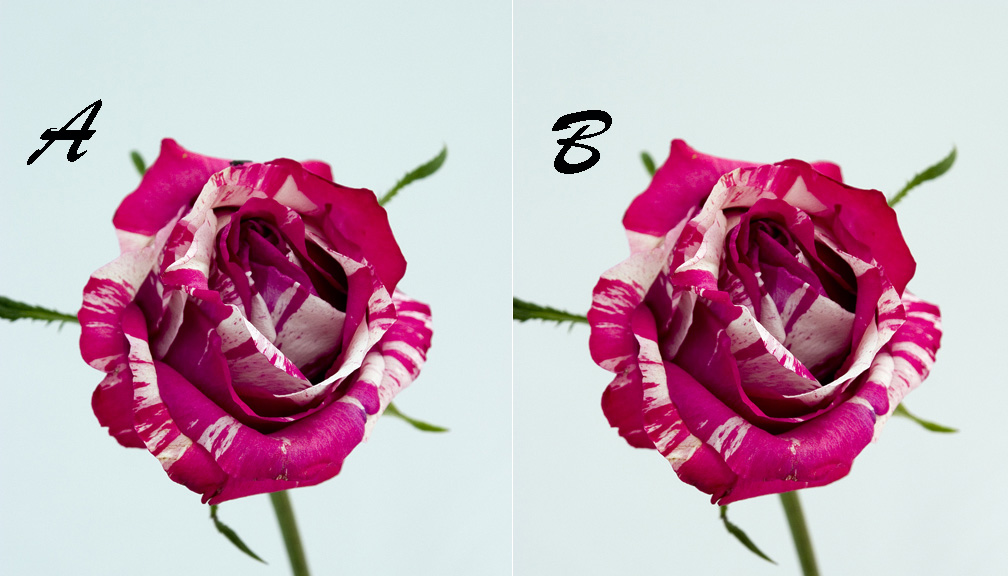

                I can see a little difference in Patricks, but not enough to worry about, if i had to guess I would say 'A' had the filter on

                  Patrick, if I'm truthfull I can't see any difference in sharpness, however there is a slight colour difference. I'd say B was with the filter off but I'd be guessing.

                    That's exactly by thoughts, as a matter of interest the camera was tripod mounted, image A with filter, image B without, processed in Lightroom exactly the same, in fact used the sync option.
                    Says a lot about Kood filters, real value for money I would say.

                      Staggering! I have never seen this before. Surely if that difference were normal, there would not be the never ending argument about whether or not to use a filter?
                      I think there must be something wrong Stephen. Shall I mail one of mine for you to experiment with? Or perhaps pop into your camera shop (will you ever be able to again with that lens?) and just try a couple of shots with a good quality filter on?
                      I have several makes of 77, and will happily send a few up to you. They wouldn't be away for more than a week and I can hack that.

                          Wow, I'm genuinely stunned by the effect of that dodgy filter, however I suppose you can console yourself with the knowledge that it was included in the price of the lens, so you haven't really lost out financially.
                          Personally, I don't use UV filters at all; although I'm not for a minute suggesting that those who do are wasting their time. Like you, I've always found that a decent hood and careful positioning of the camera prevents most problems. I did have a couple OF UVs when I was a Nikon user, but I found that my images were naturally sharper without them fitted, so they were left in the bottom of the camera bag..............anyway, each to their own

                            I've noticed a similar effect in the past but not to this degree.
                            When I was younger I used to keep a filter on my lenses "for protection". I stopped when I did some tests and realized that I was (marginally) affecting quality while I had never actually damaged a filter so probably would not have damaged a lens either. That was several years ago and I've still not damaged the front element of a lens (I'm now touching wood and crossing my fingers incase I've tempted fate )
